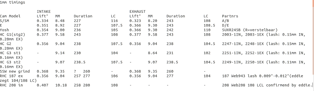

Hi All, Moin,
a member asked me for camshaft data. This is what i know so far.
I hope it is readable in the browser.
All at 1mm
INTAKE EXHAUST
Cam Model Lift" MM Duration LC Lift" MM Duration LC Partnrs/note
S/SM 0.334 8.48 227 116 0.323 8.20 243 108 A/B on the side of the sprocket
E 0.351 8.92 227 107.5 0.366 9.30 243 108.5 D/E on the side of the sprocket
Yosh 0.354 9.00 236 105 0.366 9.30 242 110 SUXR245B (R=same spec, but adjustable sprockets)
HC G1(stg2) 0.377 9.58 243 108 0.377 9.58 243 108 2003-1IN, 2003-1EX (lash: 0.15mm IN, 0.20mm EX)
HC G2 0.356 9.04 238 107.5 0.356 9.04 238 104.5 2247-1IN, 2248-1EX (lash: 0.15mm IN, 0.20mm EX)
HC G3 st1 - 9.14 230 104 - 8.64 231 102 2251-1IN, 2252-1EX (lash: 0.11mm IN, 0.16mm EX)
HC G3 st2 - 9.07 238.5 107.5 - 9.07 238.5 104.5 2249-1IN, 2250-1EX (lash: 0.11mm IN, 0.16mm EX)
SSW new grind0.368 9.35 ? 260 - 0.368 9.35 260 -
RHC 187 ex 0.356 9.04 257 277 106 0.356 9.04 277 104 187 Web943 lash 0.009"-0.012"(eddie zegt 104/108 LC)
RHC 208 in 0.407 10.18 258 280 108 - - - - 208 Web208 108 LCL confirmend by eddie.

Ok. That is not readable.
Is this better?
Is this better?
